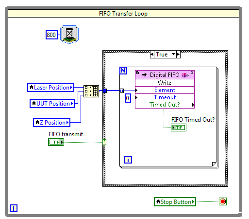

As an example, the following loop is code in one of my FPGA targets:
Every 800 clock ticks (at 40 MHz, that's 50 kHz) I read the count value from three counters (Laser Position, UUT Position, Z Position, generated in another loop at 40 MHz). If the FIFO transmit boolean is true, I write these three elements into the FIFO. In the next iteration, those three elements are added to the end of the FIFO, and so on and so on.
On the host, I read from the FIFO and decimate the data as appropriate.
This is the recommended method for transmitting multi-channel data from FPGA target to host.

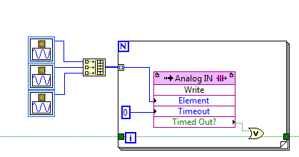

I have tried placing the data into the FIFO the same as in your example but exactly the same thing happens, for 2 inputs it works fine but for 3 it doesn't.
I have this on my FPGA:

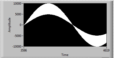

And this is the result:
The 'top' of the peak is at 10k (the amplitude of sine 1) and the 'bottom' of the peak is at 5k (the amplitude of sine 2) while sine 3 is nowhere to be seen (set at 3k)
There is a possibility that I am missing something obvious, seeing as both fail at 3 inputs so feel free to mention anything that could be affecting it, no matter how simple.
EDIT: Just tried doing the interleaving and the decimate on the FPGA and it works fine so the problem is definitely with the way the FIFO handles the data.

I see an array with the values in the wrong order, but it is not completly random as the resulting waveform is very uniform. Zoomed in the waveform is sine shaped but instead of a smooth curve I see more like a sawtooth waveform as the points switch from one sinewave amplitude to the other, that is why the waveform on the image appears to be coloured in.
To recover the data I use the decimate 1D array if I have used the Interleave 1D array to send the data, or when using the way you suggested I used the index array function. I have tried variations on these themes but that doesn't work either.
Maybe I can have a closer look at the data to see if it is consistantly wrong on every run of the program, if so then I can just correct it in the code.

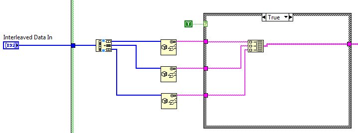

Ah, I see. You also need to use decimate 1D array using this technique.
On the target, using my method, you write data into the FIFO of:
A B C A B C A B C A B C etc
On the host, you read a number of elements from the FIFO. The result is an array of datapoints. You want to separate out the datapoints so that you have an array of As, an array of Bs, an array of Cs. This is where you use decimate. The relevant code from my host:
Read all elements in the FIFO:
Decimate the array from the FIFO to return my original three arrays:
An alternative to using decimate to reconstruct the original three datasets would be to use a reshape array primitive and wire accordingly. This would allow you to change the number of channels you decode into programmatically.

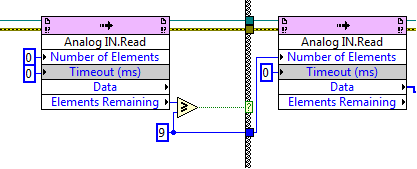

I have finally managed to get it to work and the problem was nothing to do with the interleave array or the decimate array but in fact was caused by the way I was checking to see if there were elements available.
This was done as follows:
Previously the '9' was a '10' which meant that there was always an extra element read (as 10 is not a multiple of 3) that was just attached to the end of the decimated arrays. It worked for 2 1D arrays as obviously 10 is a multiple of 2, it also explains why it didn't work for 4 arrays.
Glad you figured it out! As a suggestion for future posts, if you had attached that screenshot to your first message, we might have gotten to the solution a lot faster.
