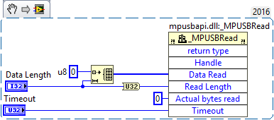

Thanks for the feedback! I do initialize an array the size of the read length, and pass that into the data field on reads.
Should I be passing the pointer, rather than the value for the handle?CodeSnippet.png
No! Make the datatype a pointer sized unsigned integer instead of a 32 bit unsigned integer! And use an unsigned 64 bit integer control on the front panel for passing the handle around. The read function in the snippet looks ok so far.
Are there other functions that you call that require a buffer to be passed in?
