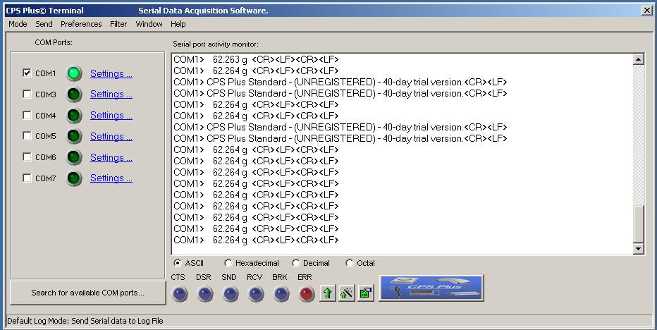

and by the way, this is the output form the other serial program (notice the end characters):
