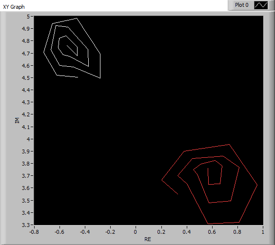

All your VI has is two complex arrays so it is not clear what you actually want. As has already been mentioned, you need to define what "interpolate" actually means in your case.
  • Do you want to interpolate RE and IM individually?
  • is RE=x and IM=y and you want to interpolate IM for any new RE? (such as if you graph complex data on an xy graph).
  • Interpolation typically works on one array. What is the purpose of the second array?
  • What result do you expect from the current default values?
  • If we graph your current data RE vs IM, we get the two curves shown. I cannot image what "interpolate" could possibly mean.

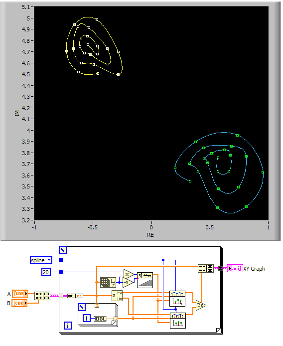

Well, he could do a spline on RE and IM as a function of array index (e.g. time) with 10x more points. (example)
Message 7 of 17

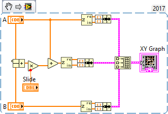

Well, here's what my assumed solution looks like. Slide=0.2.
Would be nice to get any feedback on what OP wants...
