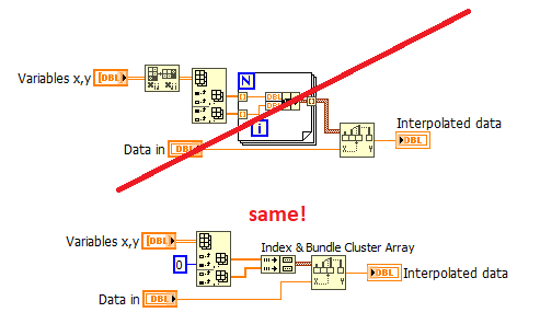

On a side note, your current 1D code could be simplified by indexing by column (eliminates the tranpose, note the 0 wire to the bottom index) and by replacing the FOR loop with "index & bundle cluster array".

Your verson of my code is really neat and I was chuffed at my attempt, I will get there one day and know what to aim for!

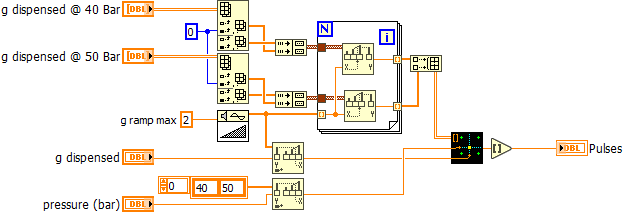

Now you need two "data in", one for pressure and one for the desired grams.
Output would be a scalar "# of pulses" needed, right?

Sorry for delay in thanking you for your help on this and used some of your code from earlier posts.
Done a bit of 'mix & match', its not elegant but it works for now and have attached vi in case its of use to anyone.

Ah, I forgot about that discussion. Here's what I came up with a long time ago. One problem is that the two calibration arrays have different g ranges, so you would need to some range checking. Right now you'll get edge values if out of range.
I still think fitting the data to a 2D polynomial would be better.
