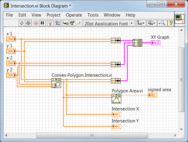

There are two VIs that need to be used. First, you need to use the Convex Polygon Intersection.vi to find the intersection points. Then you need the Polygon Area.vi to calculate the area from that polygon returned from the Convex Polygon Intersection.vi.  You can find these two VIs in the Computational Geometry Palette. See attached.
(8,867 Views)

I justs did a quick check and did not see the Convex Polygon Intersection VI in LV 2011.
It should not be too difficult to write your own.  You need to consider several possible cases: The polygons do not intersect.  The polygons have exactly one point in common (vertex of one is on an edge or vertex of the other). The polygons have segments of one or more edges in common. One polygon is completely contianied within the other. And the case you showed where the polygons overlap but do not share an edge or vertex.  If the polygons can be concave, some additional complexity may be involved.
Some straightforward analytic geometry will allow you to locate the intersections of the two straight lines formed by edges of the polygons. Then you need to determine whether the intersections are on an edge or outside the polygon. Once you have located the 4 (or zero) points of intersection which are relevant, you can use the Poylgon Area.vi, which is in LV 2011, to calculate the desired area.

I also checked and the Convex Polygon Intersection VI is not part of LV2011.
Another approach would be to use the Point in Polygon.vi to verify if the vertex of one polygon are inside the other one. You have to do it both ways ( Polygon A in B and B in A) because a polygon can be included in the other one. Once you have determined wich vertex are included in the other polygon you can use the classic analytical geometry methods to find your answer.
