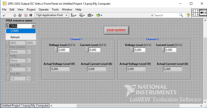

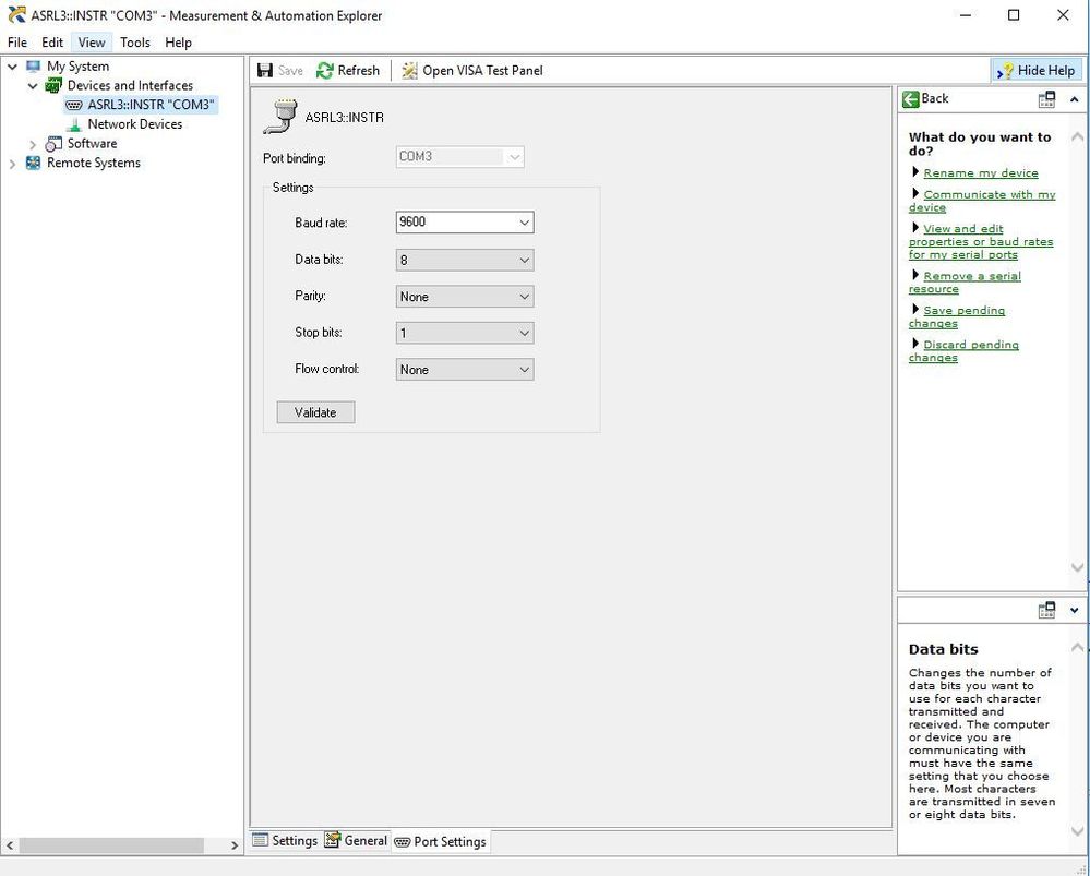

This is the panel for main VI, and it finds the COM3 port, to which the power supply is connected. It also sees it in MAX:

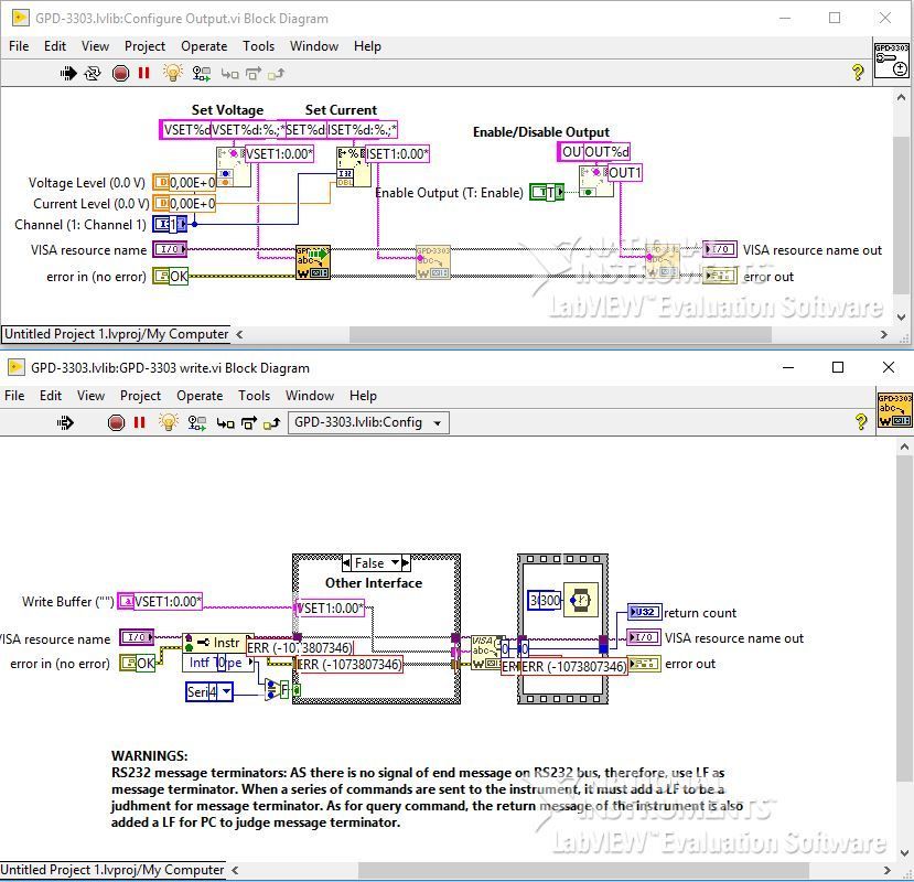

In depth it looks like this:
It fails here, and what I noticed is that (I think) the VISA resource is not being passed to this block. I think so because "Intf type" returned 0, whereas if I manually set VISA resource in this block and run it, it returns the proper value "4".

I think you are using the functions provided by the vendor improperly.  This is a VISA instrument, but they seem to be providing the drivers for you.
With VISA, you generally do the following:  open the VISA connection with VISA Configure Serial Port, do VISA Reads (or Writes), and finally release the Instrument with a VISA Close.  Presumably the functions provided by the Vendor incorporate these calls -- be sure you are using them correctly.

>> It runs well the first time, but every consecutive time it fails.
Definitely COM port is not closed properly. Check If example has VISA close in the last VI and that it executes. Also it is better not to call internal VIs - without the VISA close.
Just in case... Do you stop VI by Red Abort button, or by Stop Output program button? Abort will not call VISA close.
