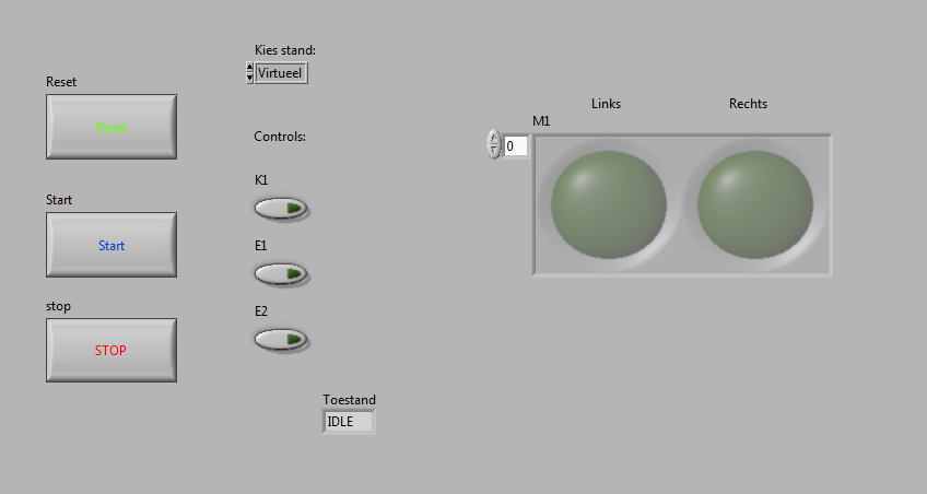

Here is a printsreen of the program. Simply put, the box under "Kies stand:" has two options: virtual and real. So when it's Virtual, he buttons K1, E1 and E2 should be clickable. However, when the option is real, these get inputs from the DAQ. I'm using a few local vars, but didn't think the race conditions through so I'll try minimizing that. However I still don't understand how I could do this even with local vars.. I have to work with local vars anyway, since I'm going to have a different DAQ module I think.

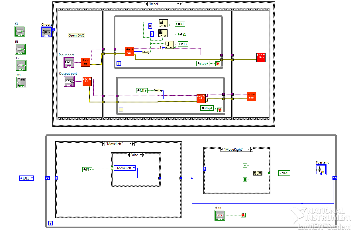

Here's the current code, in a case. In the top while loop there is also the 'virtual' option, where nothing happens.
Here's another sot of the bottom while, where the 'reset' and 'start' buttons are used.
Oh, and the red boxes are drivers to use the DAQ, they initialize, read/write and close the connection.
