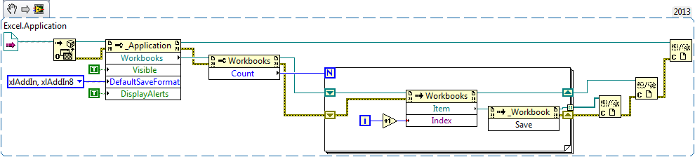

This should work:
If you want to change the path or have more control on the options, you could replace the '_Workbook/Save' method with
In this case, if you want to avoid additional pop-ups, make the 'Visible' and 'DisplayAlerts' properties FALSE when you open the Application in the first ActiveX node

Thanks for trying, but that's not quite enough info to get me there.  To use that function you still need the report reference which is what I'm looking for.

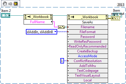

This worked.  Here's a slightly tweaked version that worked for me.  Thanks for the help!
