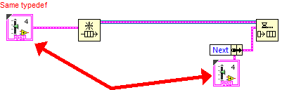

If that's the case then I would definitely suggest typedefs. All the things we were talking about here were ways to achieve what you were asking for, but there are only a few cases where something like this might be useful and I don't think that yours is one of those. Here's how a typedef could remove the wires:
Once you have a typedef you can also pass the queue reference into subVIs and do some of the work in there, so that each piece of code becomes simpler.

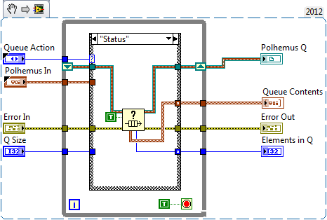

For me, a (minor) downside of using Queues is all those wires everywhere!  So I tend to use what I call Wireless Queues, which have been discussed fairly recently in the Forum (talking about speed/efficiency).  Basically, you build an Action Engine for a Queue with all of the Queue functions (Obtain, Enqueue, Enqueue Lossy, ... Release) except Dequeue as the "Action" (I use an Enum that I call Queue Action to hold these choices).  Since in most cases none of the Queue actions (except Dequeue) will take appreciable time and prevent other Actions from being called. there should be no problem having them in the same VI and being called from multiple places in your code.
Dequeue, however, typically "waits forever" for something to appear in the Queue.  If Dequeue was present in this Action Engine, and you called for a Dequeue Action before you put something on the Queue, you'd be stuck -- the first call to this VI, Dequeue, would "wait forever" for something to appear, blocking the second call that was trying to fill the Queue!  [True story -- I made this stupid mistake at least twice before I "learned my lesson" ...].
I've attached a Snippet of one such Queue, whose input is a Cluster.  I'm illustrating the Status Action, which I use for three things -- in this particular example, I'm using it to give me a copy of the entire Queue by setting "Return Elements?" to True (normally I don't use this), am returning the number of elements on the Queue (useful to tell when the Queue is empty or getting full), and also to return the Queue, itself.  I use this as a "trick" when I want to Dequeue something (typically inside a While Loop) -- I put Status outside the loop, bring the Queue into the loop, and connect it to the Dequeue.  Very quick (and you only need to do it once) and otherwise doesn't affect the Queue.
