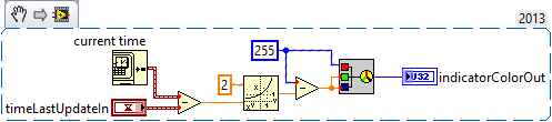

Yes, what I put up was a suggestion for a subVI using the code in your post as a starting point.  I don't know how many indicators you have on your front panel, nor how many you want to show their update age. What I am suggesting is that you stick this in between the point where the indicator value can be changed and the indicator itself. You don't have to pass things as references, just wire the data you need to the connector pane of the subVI.
Thinking about it further (I have slow neurons sometimes), scratch the last snippet I posted. You don't even need a loop at all. All you need is the information of when the indicator was last updated available (you could record that in the mainVI). Remember, your indicator could have been updated resulting in the same value as the previous one, so just checking numbers for change won't do what you want.
Whenever you refresh the indicator(s), you don't need any "Update?" control - just feed the lastUpdate value into the subVI and you'll get the right color number, which you can feed directly into a property node for the main VI FP indicator. Since you are just calculating a number, you don't even need to use the indicator itself in the subVI, as long as you remember which one it was (this is where the array of clusters in the mainVI comes in, to permanently link the two: indicator + lastUpdateTimestamp). Just remember to update your timestamp in the mainVI if you are updating this indicator. That simplifies it even further.
So, here's the (greatly simplified) snippet, 1 input, 1 output:

I really didn't want to have to change the parent program a lot, so what I've come up with now is the following. [I suppose I could work a bit more on the names of the VI's].
"value age.vi" is the parent, which calls the subVI "parentcontrols2.vi" every main loop iteration
On the first execution, parentcontrols2.vi scans its parent for digital indicators, and registers an 'value change' event for each. Each time that event fires, the last-update-timestamp is reset. In case of a timeout, the background becomes increasingly red.
Seems to work (I will have to see how well this scales). Only caveat is that now the parent will have to use the value-change-(signalling)-property-node to update indicator values, or else the value-change-event in the subVI won't fire. But it seems less screen-cluttering this way than keeping track of changes of each indicator in the parent VI.
