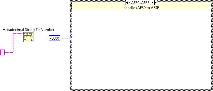

Since you already know the content coming in, why not change the string to numeric and use the numeric in case structure values?
You can combine numerics for example 47.. handles all values 47 and up
Something like this?
