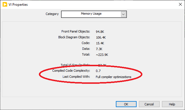

  • If the diagram (current VI and all inlined subVI exceeds a certain complexity, the computer will reduce the optimization efforts in order to reduce the compile time, so the compiled code is less efficient. If you keep subVIs reasonable, they will all compile with full optimizations.

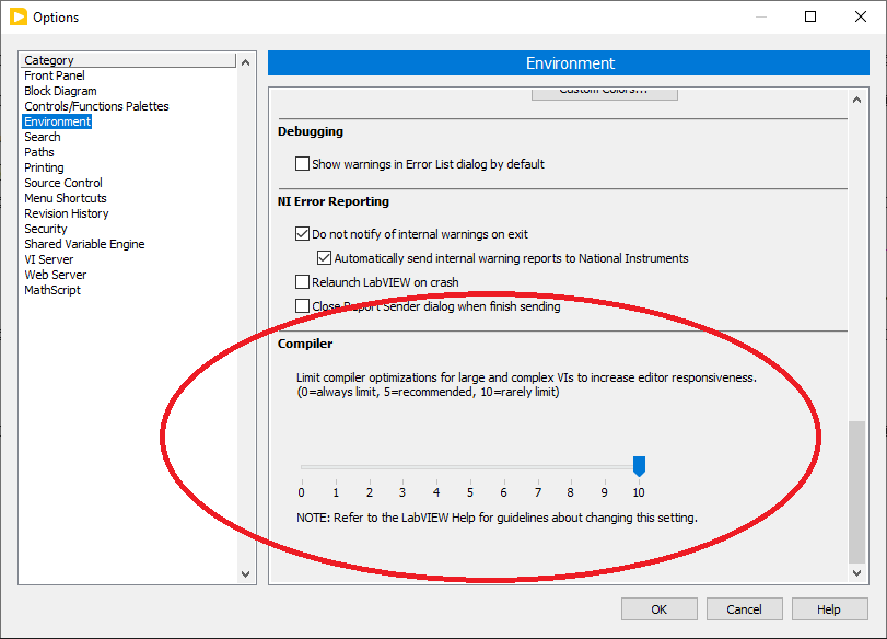

Check the code complexity in VI options:
Adjust the threshold if you prefer optimizations over compile time:
