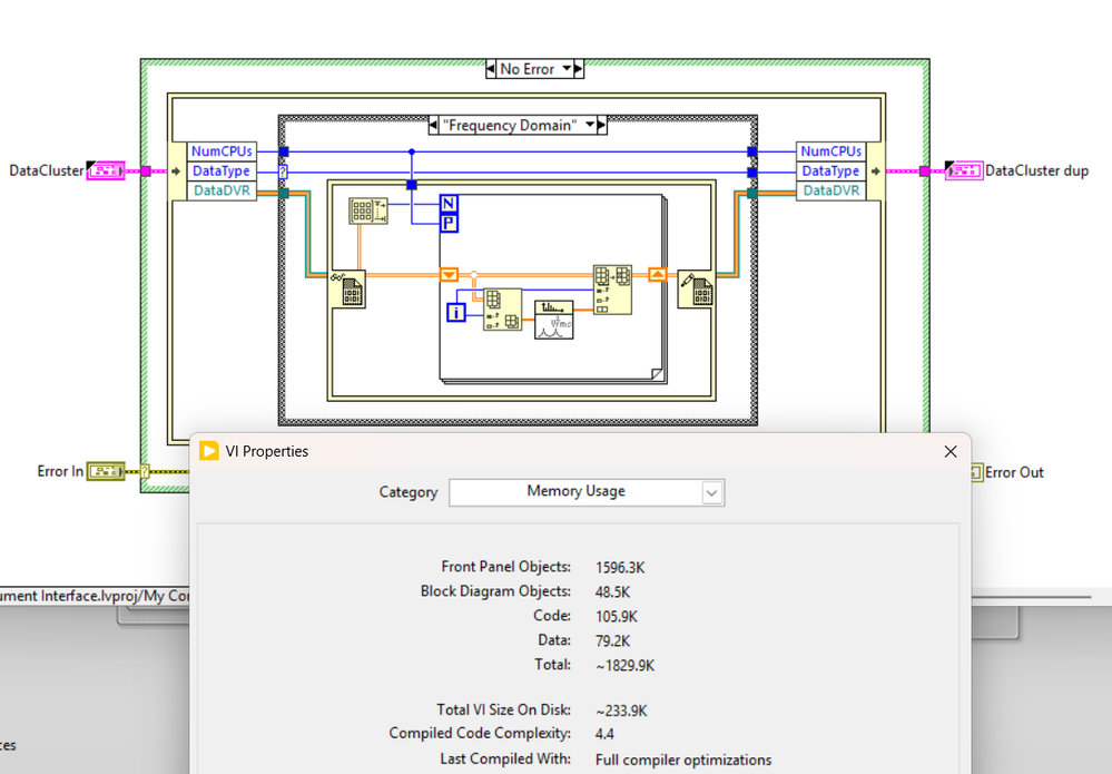

@Yamaeda wrote:
Generally there's no performance hit in upgrading, but there have been a couple of instances where some specific feature has been bugged. I don't think this is one of those instances though.
I have had weird issues with updating to 2024Q3. Below is one example, sorry I cannot share. The case structure has 2 cases, the one not shown is a pass through, just wires across the case structure. In 2024Q3 the Code complexity is more than twice before, whereas, in 2021 I believe it was 2 or lower. Not sure what is going on.

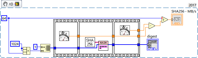

I think it's better to check with a simple benchmark instead of guessing.
Attached is a "stripped down" SHA256 taken from LV2025, downgraded to LV2017 (this is the oldest version I have on hand). All SubVIs are renamed to ensure that exactly this code will be executed under the test and not from vi.lib.
Code:
Results on Intel Xeon W-2245 @ 3.90 GHz:
LV2017 32-bit — 56.6946 MB/s,
LV2025Q1 64-bit — 44.0877 MB/s.
Yes, latest LabVIEW seems to be slightly slower on the given code.
