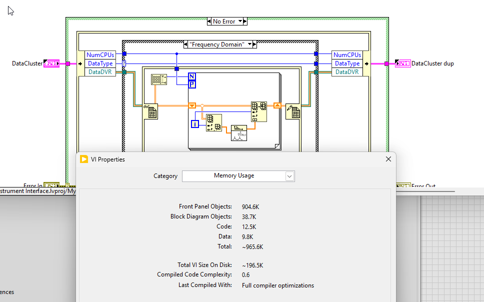

I have had weird issues with updating to 2024Q3. Below is one example, sorry I cannot share. The case structure has 2 cases, the one not shown is a pass through, just wires across the case structure. In 2024Q3 the Code complexity is more than twice before, whereas, in 2021 I believe it was 2 or lower. Not sure what is going on.
Intriguing. Looks like some optimization thing, maybe it unrolls the loop? Is the performance any different?
Don't know. I do not have different versions on the same computer to compare. This computer has 2021 installed, the same VI has a code complexity of 0.6, whereas the 2024 version is above 4.
I am guessing that some of the updates are changing parts of the compiler. I have had issues compiling things that I never previously had. Hopefully, it will all be worked out sooner than later.

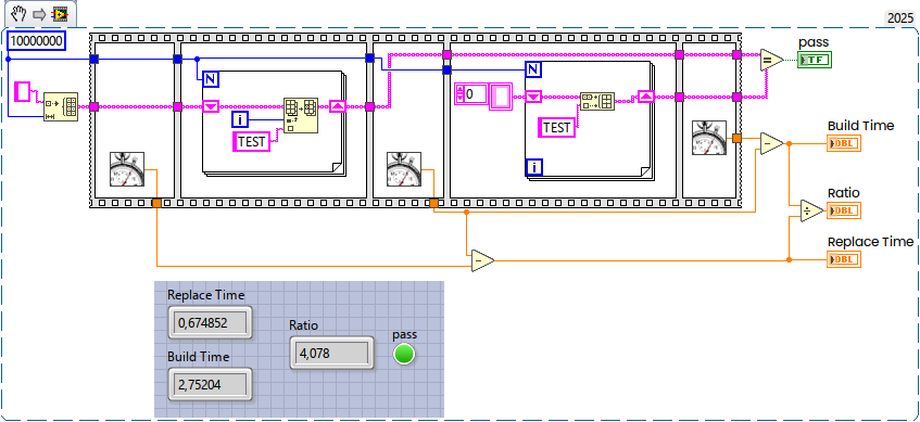

Of course, Build Array is slowest, this is fully expected result:
On my PC by factor 4.
