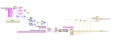

Is there a way to change the time of a saved data to be as the same as the time-axis of the waveform graph?
Good morning Dennis,
Here is a pics of how the waveform is being generated.
I’m not sure I know how to continue
Thanks for the help, Erez

Hi Erez,
wow, what an image! Scaled down to 400 px width - from former 1600 px?
What should we see in that image?

Trying to save some space on the web…..
Just want to clearly that to comes out from the scope reading – nothing to do with the old/new waveform.
I think the way to go is trying to read the trigger time and use that as zero of time

That is clearly a waveform data type being generated and as I said, the scope data is being coerced to a timestamp. Use a regular bundle/bundle by name.
