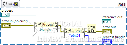

The snipped as shown by klynn is wrong. The IsWow64Process() function takes two parameters as shown on MSDN. The snipped only passes the handle to the function, not a second parameter to receive the boolean status if the process is a Wow64 process. In addition, the Windows handle returned by the .Net node is not directly the Window handle but a .Net object refnum. You would need to convert it to an Int64 value first through a .Net Invoke Node, before passing it to the Call Library Node as Window handle, and configure that parameter as pointer sized integer instead.
To add even more trouble that function only returns true when the process in question is a 32 bit process running on a 64 bit Windows system. a 32 bit process on a 32 bit system or a 64 bit process on a 64 bit system will return false, so to really get the right information about the process bitness you would first have to determine if the system itself is a 64 bit system, which incidentially one has to call  another Windows API function for. LabVIEW only returns if it is itself a 32 bit or 64 bit process, not the bitness of the underlaying OS (although if that property returns x64 then the system obviously has to be 64 bit too).

I looked a bit more at the original snippet and there is even more wrong with it! IsWow64Process() expects a process handle, not a windows handle. So that is not likely going to work. In addition to that it seems not possible to retrieve the actual handle value from the refnum. The returned value is always 0. Not sure what is the problem here as .Net is not my domain of expertise. But it is definitely a bit more complicated than the snipped in this thread.

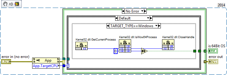

This is the code to determine if the underlaying OS is 64 bit. It does so by first checking if the LabVIEW instance is 64 bit. If this is the case it must be a 64 bit OS since 64 bit LabVIEW only runs on a 64 bit OS. Otherwise it checks if the process is running under WOW64 using your Windows API function.
Integrating this into the earlier example with all the corrections I pointed out earlier and hoisting out the IsWow64Process() call to use for determining the bitness of each enumerated process is left as an exercise. Please note that I wasn't able to get a valid process handle from the .Net nodes in that example, but I didn't try to hard, so it might be just something I did wrong. It's definitely touching Windows security limitations somehow were arbitrary processes aren't just allowed to simply query any characteristics of other processes as some of the property queries for the Process class will actually return an error to that effect.

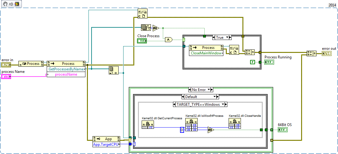

You have to use the IsWOW64Process() Call Library Node. Somehow you have to convince the .Net Nodes to return to you the numeric value of the underlaying handle for each process. Whatever I did I always got 0! The greenish wire is an object refnum not the handle itself.
It should be something along these lines:
However I was not able to get a meaningfull process handle value from the .Net functions as I have already explained. Didn't try hard though as I have other work to do here.
