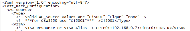

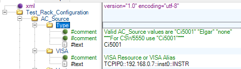

I store all my instrument VISA information in an XML file.
This is what in looks like in XML Notepad
Raw XML file
I parse the XML and type cast it to a VISA Resource type because I have an aversion to coercion dots 😛

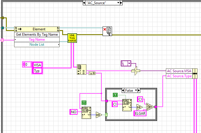

Yep, I did something similar.  XML Notepad is a great tool if you are doing XML.  But, as I said earlier, I had a lot of trouble debugging the parsing code (kept getting confused about what layer I was in and the reference doesn't give the information I needed).  I switched to JSON and the JSON Text library because the library allowed me to see the actual strings being parsed and therefore debug.  I also don't need a special tool to do JSON effectively.

@crossrulz wrote:
You are right XML parsing can be confusing and I pretty much have to relearn how to do it every time. But as long as I stick to the same basic XML file format I can use the parser I made long ago. So I end up making the XML fit the parser instead of the other way around.
