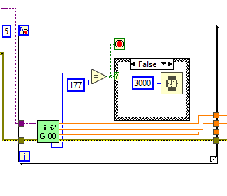

This is a lot of good info, Iv'e only been through core 1 and doing this a few months. I will have to mess around with it to parse it into a cluster. I will use some of the subarrays in the future, but really I just broke it down this way because it was easier for me to count what bytes had already been broken off. Also, this VI will be shared to other people who may have a use for grabbing those other bytes of info to suit their needs.
As for the solution to my problem...
I added a byte return count indicator to my connector pane in the G100 and then compare that value to what I should get, then repeat the command if I don't get it. The UUT sometimes throws out less bytes than the 177 that I should get.
Wouldn't have come up with it without everyone's help, thanks!
