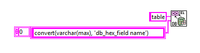

OK...in the select data VI, use the convert command....similar to this.

Actually, that will not do what you are asking.
