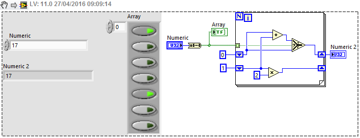

The simplest functions you need for this are Select or case, Add, Multiply and a shift register. You iterate over the array and if the current value is T, you add N to the running total, where N is the current power of 2. If the power of 2 function is available, you can use that on the i terminal. If it's not, you can simply track it yourself with another shift register and multiplying the value in the second SR by 2 in each iteration.
This code is a very literal interpretation of how binary numbers are represented.

I understand what you're saying, and it will work, but could you explain a little more, or maybe show an example?
My understanding: I have an array, it goes into a for loop through a shift register, then into a case structure of true or false. If it is T, then it goes into another for loop and is added to a power of 2 function whose x is connected to the i of the outside for loop. There are some errors I know, but can you show me what I'm doing wrong?

I got it to work finally. Thanks to a combination of your answers! Thanks so much for all your help. (I probably still WAY overcomplicated it).

Not that part, but the rest of it, yes. I didn't examine the code closely, but there are a number of things which jump out even on a cursory look:
  1. The most obvious issue is that you have duplicated code. When you have something like that you should pretty much always think loop or subVI. The point is that you should have one copy of the code and give it the relevant parameters. This makes things easier to write, easier to read, easier to understand and easier to debug.
  2. Cleaning up helps a lot. Straight wires make a straight mind.
  3. You don't need to tell the for loop how many times to run if you're auto-indexing. That operation sets the number of iterations.
  4. If you want N elements out of an array, there's a function for that. You don't need a loop. I'll let you find the function yourself.
  5. For completion, here's the primitive code:
  6. Note the use of appropriate data types, as well as the fact that this code is basically also a test that it works correctly.
