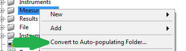

I am working within the Project or within the Library, both within LabVIEW.
The newly create VIs would be saved to a folder where the other library files are also located.
The "Convert to Auto-populating Folder..." right click option is not available inside the library.
That is correct and mandatory.

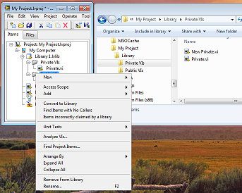

OK.  I understand now how to make a new VI easily part of the library.   Thanks.
If I right click on the library in the project and select New >> VI then the VI will be in the library.  Even though it is say in the Private VIs folder on disk I have to move it there in the library from within LabVIEW.
If I have the library highlighted and select from the menu File >> New VI the VI will be in the project and I will have to add it to the library by moving the VI from within LabVIEW.
This is what I was doing and seemed overly complicated.   I would get several VIs that were not listed in the library this way.
By using the right click method the VI is at least in the library although I have to move it to the correct virtual folder.
Thanks again this helps.
