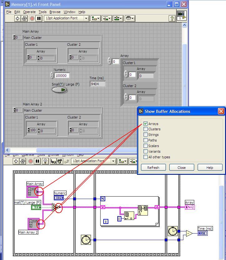

To illustrate that clusters and arrys are the the handles+data I put together the following code.
As shown buffers are allocated in the initial frame and re-used the rest of the example.
I have configured the two controls "Main Array" and "Main Array2" such that the both contain a single element.
The single element in "Main Array" only has a single element in the array of the first of its sub-clusters.
The single element in "Main Array2" has 10,000 values in the array in the first sub-cluster.
So since I am doing everything "in-place" (not creating new buffers) and if copying an array element is simply a matter of copying a handle over-top of itself, THEN it should take the same amount of time to replace element 0 with element 0 for both "Main Array" and "Main Array2".
Running the VI shows that this is NOT true. The small array 50ms and the large about 9 seconds.
