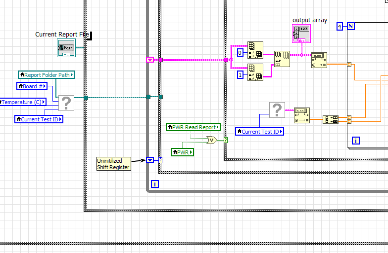

Okay my program is attached. The picture below shows where I am reading the incorrect limit values. (Sorry for the messy VI, I am still developing/debugging)

Maybe this uninitialized shift register?Maybe this uninitialized shift register?

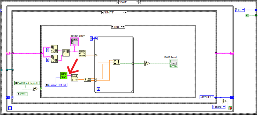

But that uninitialized shift register is going to remain in the "DONE" state after your first run unless the VI is recompiled or closed and opened.
On the first run it will go to the "default state" because the shift register is empty, but on the second and any run after that the shift register will be holding the "DONE" value so it will only run the DONE state.
So on the next run it will not actually do any of that part of the program and you will be left with the data from the last run.

There are quite a few uninitialized shift registers  (Cases "TVFIL",  "TVFREJ",  "PWR"). You can replace them with globally initialized feedback nodes or play with the "first call?" primitive.
