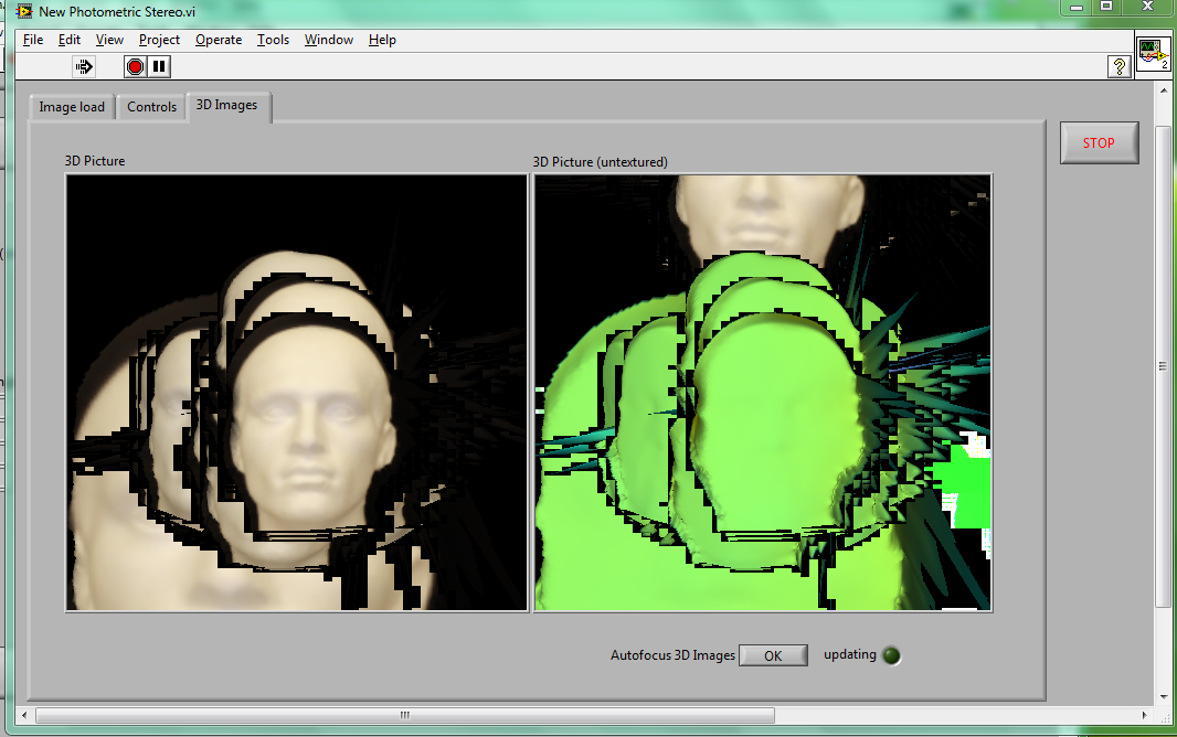

I have been experiencing a problem with LabVIEW when displaying an image. It is a 3D picture so there are two displays, one with a texture (colour image + depth) and one without (depth only), and normaly I drag the object around to view from different sides, however I have recently been using a MacBook Pro, with Bootcamp (Windows 7), and the display does not overwrite, meaning that previous displays are appearing in the background.
Has anyone seen something like this before. Perhap it is another issue? Any help would be greatly appreciated.
I am getting something like this...

Can you post your code?
You are either having problems with the way you are handling moving the object around in your code or your graphics card is having a strange problem with updating. Your code would be my first guess.

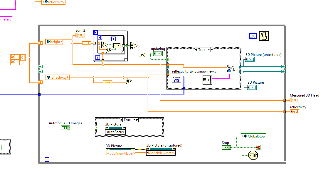

Thanks for your reply. Here is a screenshot of the code. The blue wire that enters the loop contains a 2D array (24bit colour depth image).

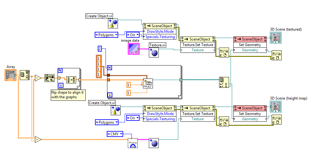

I guess that the problem could be originating in the vi called "height map to 3D" which I have also attached below.
Any further help would be greatly appreciated.
