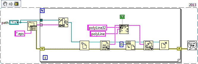

I have this issue using Windows 7 and LabVIEW 2013, that is, using the Invoke Node, Export Image, for a Wavefrom graph. All of my eps files were corrupted that I tried to export.
I do not know whether this is the case for you, but for me the following fix worked:
1.) My corrupted eps files have the command polyLine32 in it. This is the offending command. It should be replaced with just polyLine.
2.) Once I did this I was able to open my eps files in Adobe, Ghostscript, and Apple Preview without any errors.
I used LabVIEW to fix the corrupted file, see the following snippet.
Hope this helps.
