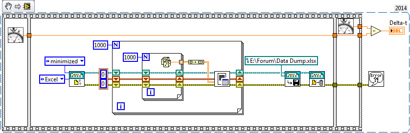

OK, I did the test.  This routine generates 1000 random numbers/row, writes 1000 rows, then closes Excel.
The resulting .xlsx file is about 6.8MB, and the entire process took less than 15 seconds, which means that it wrote a row in 15 milliseconds, pretty good, eh?
Bob Schor
