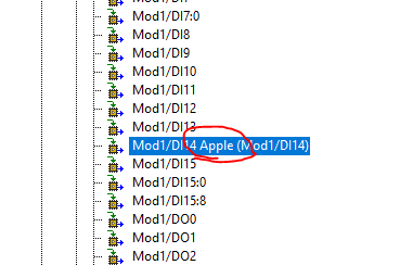

For a cRIO I need to use some IO modules with 32 IO. I think it is convenient to use human readable names (apple in picture below).
On the other hand I do not want a lot of wires so I tend to use clusters. For the digital IO a standard option is to use a U16 to group 16 booleans.
However If I use the U16 I lose the human readable names. Is there a option to use the human readable names without wiring 32 wires for every IO module by hand to a cluster? Maybe there is a simple fast trick I can use?

Thanks for the reply. I understand what you suggest. However It still feels kind of odd that one can edit the names in the module (see the text apple in the picture) which would give a good overview of the signals in your project. Which makes it easier to manage your code etc. And then I would need to make a separate typedefinition to define the signal names. If someone else has got a solution please tell. For now I think I need to use the typedefinition method you suggest. Maybe Ni could add a function to create a cluster with names when you rightclick the module.
