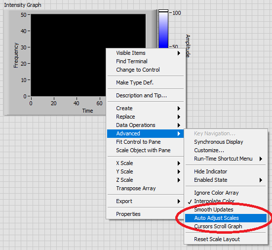

The plot area size will not change unless you have "advanced...autoadjust scales" enabled, which would automatically change the plot area to make room for changes in axis marker width (e.g. if they change from "0.2" to "0.456e-6". So disable that! (also pick a useful marker format or e.g. don't even show the axes)

Disabling the Auto Adjust Scales option is not really feasible as then of course the scales are messed up.
