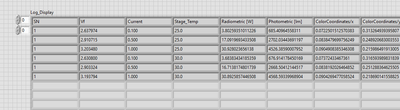

Keeping row zero "Fixed" to continually display column names
Want to be able to scroll the data below the first row however column names to remain fixed?
Can it be done?

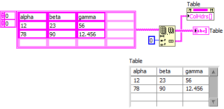

Achieve something like Freeze rows in LabVIEW? yes but not using a 2D array indicator as your headers are part of the data.
Table, Tree, and Multicolumn list box (MCL) have headers that are stationary while the content can be scrolled.

If the column headers never change, you can just type them in manually. If you want to write them programmatically, write to the property node whenever the column headers change:
(870 Views)
Very clear thank you
