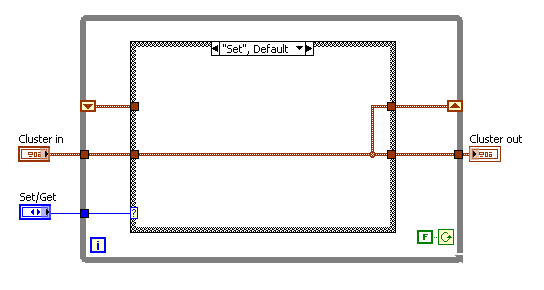

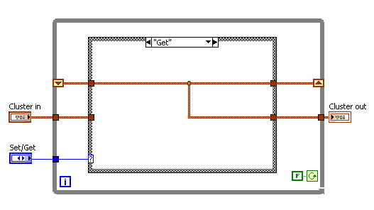

A Memory VI is probably the best: here is an example of the most simple Memory VI possible:
One advice: always use typedef for the enumerate control and the cluster when you use this kind of VI because you are going to have these controls everywhere and when you start to have a big program you are happy to be able to change them all at once if you want to.
Hope it helps!
