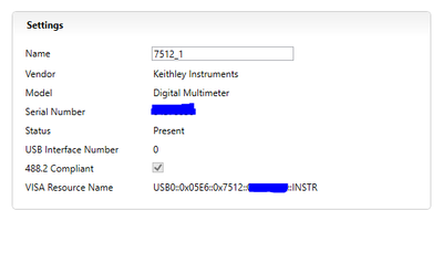

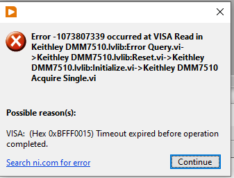

I am trying to use the example code provided in the LV drivers for Keithley DMM. I connected to the DMM with USB and MAX identifies it. But it seems to have a timeout error when I try running the example code Keithley DMM7510 Acquire Signal.vi.
The error seems to come from the IDN query however the IDN response from the DMM matches the string expression + SN and version. VISA Read happens when Query is turned off, occurs when the computer tries sending a *RST command to the DMM.
Attached is the LV drivers for the Keithley DMM that I am using, below is a picture of the error out and MAX config

That is odd. If it matters I am using a 7512, however that is just 2 separate 7510's. I tried using Ethernet connection instead of USB and produced the same error. When accessing through the Virtual Front panel via entering the ip in edge I can access the dmm just fine, however I do need to type in a login and password. Could this be the issue?
(5,226 Views)
Accepted by topic author EricLoop
I continued digging and found the solution. I connected via ethernet and accessed the virtual manual panel for the 7512. I went into the configuration setting and changed the command style from TSP to SCPI and now it works. Looks like it saves that setting on power off as well.
