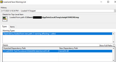

If you want to write another DLL and add a dependency to your app that requires an additional toolchain, feel free. However, this error I got opening the snippet you posted sums up your problem.

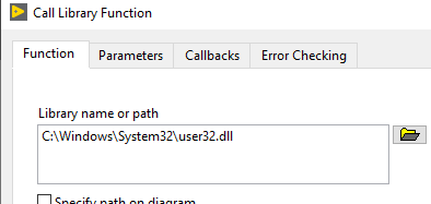

You CANNOT copy Kernel32.dll to another location. It should not be expecting to load from your data folder. Likewise, this is also wrong:
That works in the IDE, but using the full path causes the Application Builder to believe this is a private library that should be copied to your build path. That is why it breaks when you build an EXE.

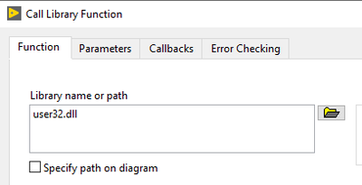

The correct way to reference a DLL that is part of the Windows system is simply this:
I think if you try the attached version, you will find it works both in the IDE and when compiled to an EXE. If you try the second version, I think you'll notice very little difference in the result.
