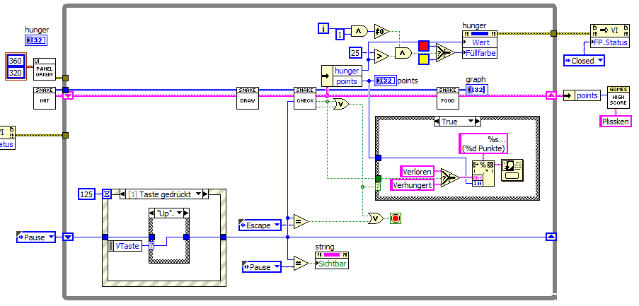

As an inspiration this is the main loop of my Snake version:
The whole game stuff is hidden in those 4 subVIs… 😄
