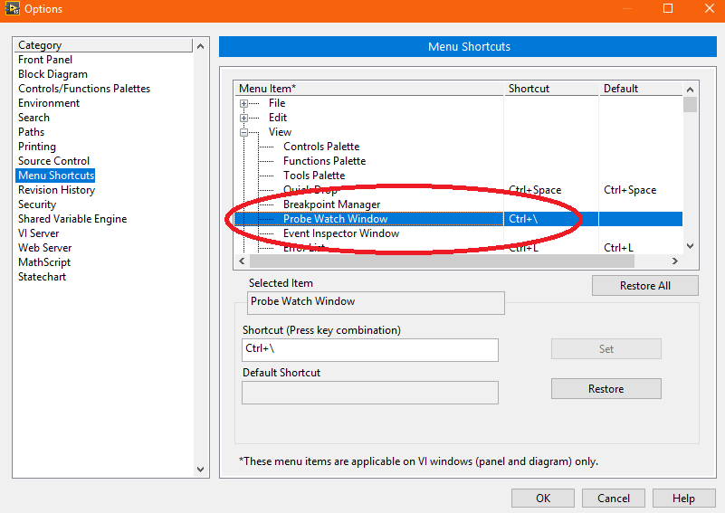

You can add your own combination in Tools->Options->Menu Shortcuts

Can you explain which tool exactly pointing to?
Edit: If you meant Tool selection-> You can make Automatic tool selection and use http://www.ni.com/getting-started/labview-basics/tools

Thanks for the quick reply. I am aware of the proble watch window, but I would like to use the place probe tool itself. Automatic tool selection does not switch to tool when I mouse over a wire when the program is not running. I will probably use the probe watch windows hotkey as well.
