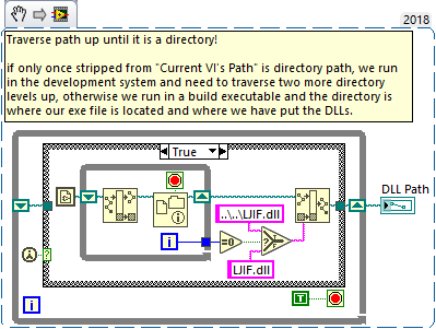

The problem is that the Keyence provided drivers (if they provide one, not all their devices have such a driver) try to be smart and determine the DLL path at runtime. Only the used function in private/Get DLL Path.vi isn't very smart and uses a convention that was valid long long ago in LabVIEW previous to version 8.0. Currently the internal path to a VI in a build executable can be much more complicated as it contains more or less the entire hierarchy.
Basically that VI should be changed to something like this:
This works for both the old pre LabVIEW 8.0 build applications as well as for >= 8.0 build applications. It requires that you make sure the Keyence DLLs are all placed in the executable directory as was the case with the previous solution too.
