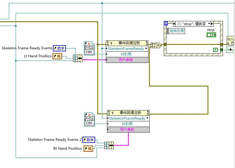

You can do like this, add one more SkelFrmRdy_EvntHdlr.In this picture,I got the left hand and right hand joint.And open the SkelFrmRdy,you should modify the value in picture 2(HandRight), Then you can get the righthand joint.

I have tried that, but when I increase the number of joints, the performance decreases significantly, and the data points update very slowly. I am on a fairly fast system as well.
