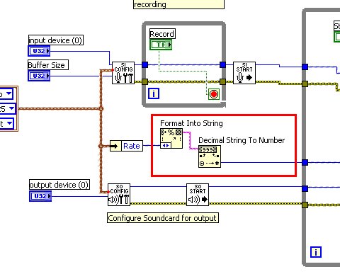

Don't use a case structure, use format into string, then string to decimal:
This will adapt to whatever elements exist in the enum, and return them exactly as they are typed.
I would not have used your method inside a loop because it is very inefficient. Besides if new values are added to the enum, an error will be generated until the case structure and the enum have matching values
It's outside the while loop.
Why is this a good thing? With an enum to string to decimal you no longer have to worry about what the enum contains, it will always return the numeric conversion no matter what. It's very versatile.
Thoric (CLA, CLED, CTD and LabVIEW Champion)
Message 17 of 30
(1,843 Views)
thanks for your helps, both of your ways work well, The Thoric's is good for me because i will build sound format into a constant, but Coq rouge's is better for every case. thanks again.
Very inefficient?
Comparing a loop of 1E7 iterations containing a case structure with a 1E7 iterations loop containing an enum to string to decimal, I get times of 49 and 66 ms each. That's 10 million conversions in 66 milliseconds for my method on a basic laptop. Hardly worth worrying about, and only a small percentage slower than the case structure. Not a candidate for very inefficient.
