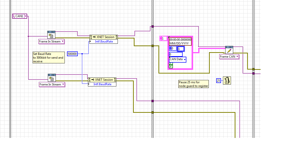

I am really happy that I can read this article because it seems like it is the similar problem that I am facing right now. I also has a really bad CAN update delay when I want to write Data on CAN bus.  I was trying to following your solusion here, use frame in single point, frame out single point. But I am not so sure that I can continue. In our labview, we use frame in/out stream(sorry the screenshot cut is wrong). But if I want to change it to frame in/out single point, it will show an error saying: mising wiring on NI-XNET block.

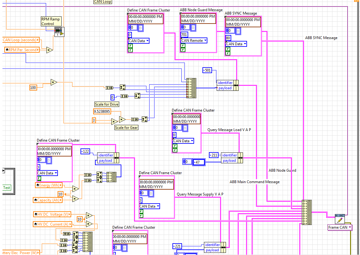

In our labview, we use a big sequence loop. So what in saw in the 1st pic I attached is the first sequence, then in the 2nd sequence we had a Frame Can write frame. Then in the 3rd one, which is in the 2nd pic, it shows the CAN write frame that contain a lot of message that I would like to write on CAN bus.

In your first screenshot, you are performing a Frame Write to an Input session. This should throw an error. You should read from input sessions and write to output sessions.
Where do you configure your output session? You don't show that on your screenshots. If you don't configure an output session, I'm surprised that the transmission works at all.
Do you have an XNET database or created objects that your are using in a project?
EDIT: Also, does the device you are communicating with actually use REMOTE frames?

I am sorry, the first screenshot is wrong, it is a 'Frame Out Stream' connect to the 'Frame CAN Write'.
I do not have an XNET database. And I am not sure what do you mean by 'created objects'. I indeed have the object that showing on the second screenshot that indicate the ID and payload that will write on the CAN.
For 'Remote Frame', we have indeed that send query message on bus to ask for status of power supply. Is this the remote frame you are pointing?

You actually always have an XNET database. It's just a matter of whether you use an external database or whether you create objects on the fly.
From your screenshot, it looks like you are creating objects on the fly using the in memory database.
Looking at your frame configuration, I was surprised to see Remote frames being configured. Most devices that I've encountered don't use them.
So what sort of session are you trying to create? Frame Out Stream does not allow for cyclic transmission. You can repeat transmissions using a software loop. If you really have cyclic frames, Frame Out Single Point or Frame Out Queued would work. The post you referred to earlier was using the Frame Out Single Point.
The XNET help is actually pretty good about breaking down the session modes. From that help, "...  this mode does not repeat its transmit. Unlike the Frame Output Queued mode, the Frame Output
Stream mode does not use CAN frame properties from the database."
So if you're using this mode and getting unexpected delays, it's likely due to your sequencing.

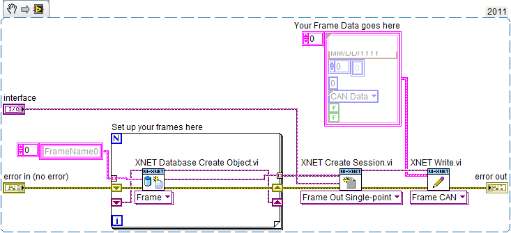

Here's a snippet of how to configure for single point using an in memory database.
You'll likely need to configure the frame properties individually.
I left out some of the good housekeeping that should be included such as closing the session and database.
(6,077 Views)
