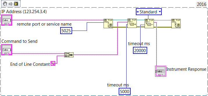

I am trying to send and receive commands using Labview to another instrument (that has its own software).
I cannot use GPIB or USB and LAN communication is the only way I can communicate.
I am using TCP/IP to send and receive commands and it seems that this method does not work. the fellowing software gets error56 (which is very common and I was not able to sort it out).
I am using TCPIP0::123.254.3.4::5025::SOCKET
Commands I am sending: *IDN?   *OPC?    :RUN
expecting to get different response for eazch command.
is there anyother method or simple software that helps me to communicate or TCP/IPis the only way. If it is, then what is the problem of my software ? (i have changed the timeout to -1 or 30000ms and still I get the same error or I dont  get anything for -1)

I would suggest that you make a few tests before having your problem solved.
First, try to ping the instrument using the command prompt.
Second, just open and close the connection using LabVIEW.
Then, use the error cluster to properly propagate the error in your VI
Finally, check the command sintax for your instrument, you may got the instrument to close the connection because it did not received the command properly. It could be as simple as putting a carriage return in the end of the string, or even wrong sintax.
Let me know the outcome from those tests.
Best of luck.

Have you tried communicating the instrument using NI Max?? It may be easier to debug the instrument comms, than by using a VI.
Couple of other things to look at in your VI:
As Guilherme said, MAKE SURE you follow your command with a \n character. Right click your "Command to Send" control and select "\ Codes display". If you don't see newline character there, you need to add it.
Most instruments use port 5025. Some do not. If you are not 100% sure, read the manual.
Your TCP "bytes to read" is unwired. I always wire it with something. Usually a VERY large number. See next comment.
Your "Mode" is also unwired and defaults to "Standard". MOST reads are terminated by a CRLF. I would try changing it to that mode. The read will automatically terminate when a CRLF is read. Thus the reason you put large number in "bytes to read"
Once you get the VI to communicate, I would suggest you use VISA commands instead of the low level TCP commands you are currently using. Use your TCPIP0::123.254.3.4::5025:SOCKET as the resource.
Message 3 of 17

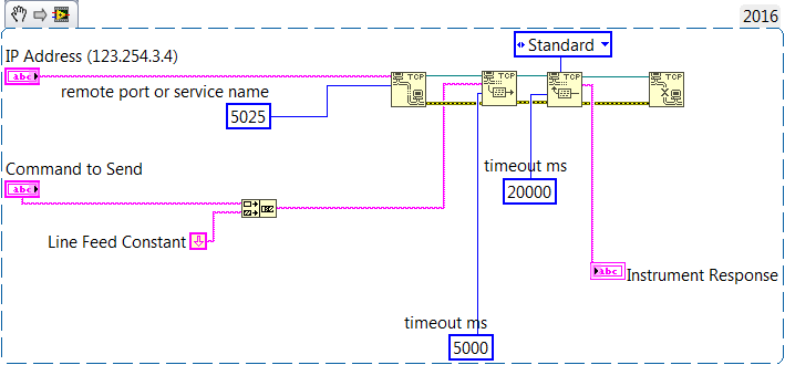

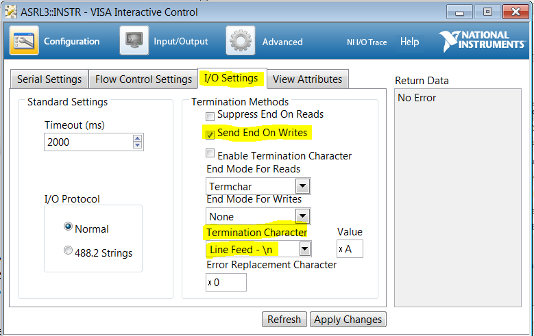

Accepted by topic author basetgh
The reason why is working when you write using the VISA Interactive Control is due to the I/O Settings, in this Tab the Send On Writes is enabled  by default, and the also defines the termination character to be Line Feed (\n).
If you change the code to use line feed instead of carriage return it should work.
Guilherme Correa

Perfect. SOLVED!Smiley Happy
Thanks a lot. This little issue took me some time.
