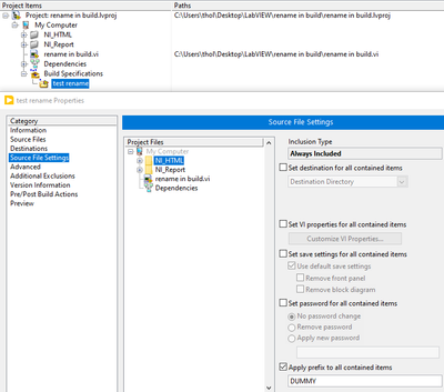

@Nils_Thomsen wrote:
I don't see the point in adding a prefix. It will simply rename all files what will bring no advantage as they later still have the same name.
If you rename one but keep the other, then they won't have the same name.
But from your picture, I think you may get another problem. I guess NI_HTML inherits from NI_Report, and if you rename one of them, then you will break that.

But I cannot rename it partially in the built options.
Message 12 of 20
(1,546 Views)
Just create a virtual folder for each, or at least the one you want to set prefix on:
Certified LabVIEW Architect
Message 13 of 20
(1,536 Views)

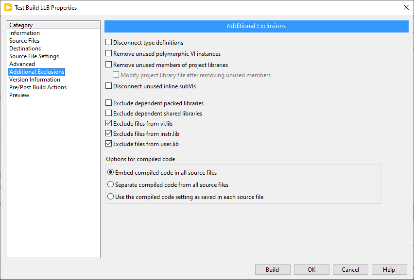

Do you really need vi.lib VIs to be included in the distribution ? I'm not sure how LV or your application would load multiple copies of vi.lib VIs anyway…
Otherwise you can solve your problem by simply checking "Exclude files from vi.lib":
I think the problem comes from the fact that llbs do not recognize lvlib/lvclass namespacing…
Message 15 of 20
(1,524 Views)
