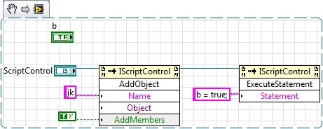

does anybody know if it is possible to wire a lpdispatch to pass an object handle as a parameter of an activex-control?
What i am trying is to use the MS ScriptControl ActiveX. I try to give my application an Scrptengine by using the ScriptControl.
As i tried to call the AddObject() Method i found that one paramater is of type LPDISPATCH. So how can I give this Method an object handle by using LPDISPATCH?

I'm not at all sure that this will really work, but have you tried to wire the LabVIEW ActiveX refnum of the according class directly to the variant input? LabVIEW can and does make a lot of implicit conversion automatically when using variants. The problem here might be that an application can pass either an IDispatch pointer or an IUnknown pointer the the ActiveX method and unless the Type Library clearly specifies that it wants an IDispatch*, LabVIEW can only guess what it should do and has a 50% chance to get it wrong.

 Hmm, i did not manage to runit, i always get Error 91. Do you have an example code snippet?

This is what I meant to try, but how you create your script engine object or whatever this method expects I can't tell you.
