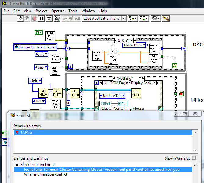

My VI has an error.
I click on the (broken) RUN button to find the error.
In addition to the error I expect, I find a bogus report (sometimes more than one).
The bogus error is always about an "undefined type", except it's bogus because the type IS defined (notice the wire to the CLUSTER CONTAINING MOUSE indicator is NOT broken).
The bogus error is always about a refnum control or indicator.
If I fix the real error (enum conflict) the bogus error does not show up.
The enum has nothing to do with the indicator mentioned.
Weird.

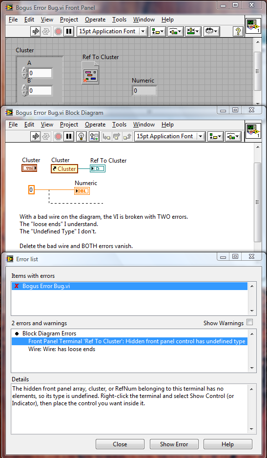

Wow, it turns out to be remarkably easy to demonstrate.
Attached is a VI.
Below is a picture of it.
The rule seems to be
IF
   a CONTROL/INDICATOR is a REFERENCE to a CLUSTER
AND
   some other error exists on the VI
THEN
   complain about HIDDEN GIZMO has no type
ELSE
   don't complain.
Just delete the bad wire and BOTH errors go away.

Hello Steve,
Thank you for the bug report. I've validated the same error occurs in LabVIEW 8.6 and 2009. This behavior is reported to R&D with corrective action report (CAR #183198) and hopefully we will address this issue in the near future.
