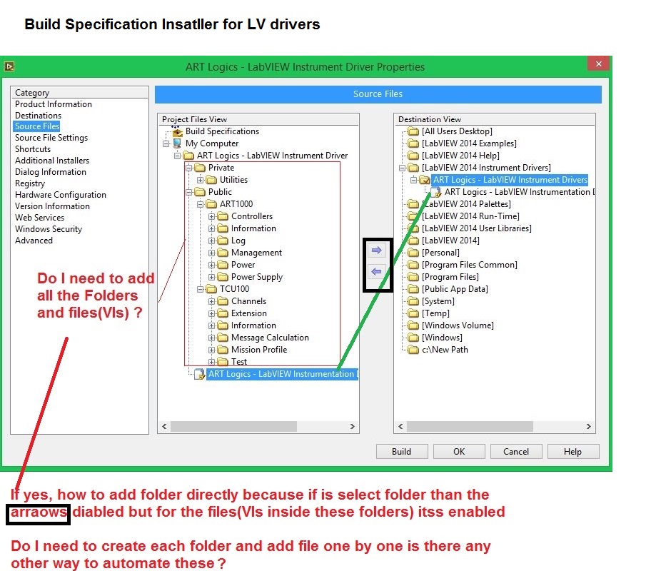

I developed a driver for the instuments and during build specfication(installer), I have some questions,
please refer inserted picture get clear view of question 1 and 2
1. to deploy thease drivers on any other PC, which files I need to add ?
2. how to add folders directly in destination view ?
2. What does these installer actually do ?(is it put my files instr folder because i Osever just if I put my VIs in instr folder it apperers  Instrumenation I/O palatte? )
Thank you for your time.
-Amit

Yes, you need to include all of your source files in order for the driver to be used. You can just zip them up as NI does with a driver. You could submit the driver to NI for approval and inclusion on the instrument driver network. At which point, the files would be zipped up like all of the other drivers there - without an installer.
(2,893 Views)
thank you for your feedback
Currently, I made autopopulating folder  and added them at once, got reference from here
Thank you.
