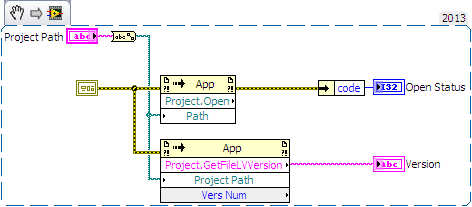

I'm writing a LabVIEW DLL to inspect LabVIEW project files, and I've noticed that if a project has a .lvlib reference in its Dependencies, then the Run-Time Engine contradicts itself about whether or not it can find the project file:
  • Project.Open returns error 7 (file not found)
  • Project.GetFileLVVersion is successful
Here are snippets from my G and C code that exercise this behavior:
   int openStatus = StatusSuccess;
   char* projectVersion = createStringWithLength(VersionStringLength);
   printf("Analyzing %s\n", pathString);
   OpenProject(pathString, &openStatus, projectVersion, VersionStringLength);
   printf("  Project written in LabVIEW %s\n", projectVersion);
   if (openStatus == StatusSuccess)
      printf("  Opened project file.\n");
   else
      printf("Error: Could not find project file, or file was not a project file (error code %i).\n", openStatus);
However, when running in the development environment, both methods succeed.
Is this a bug, and if so, is it fixed in LabVIEW 2014?

Hello MacNorth,
I can attempt to recreate this issue, although it may take some time. What operating system are you using?
