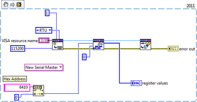

Yesterday I was getting no comms on the FTDI driver in the executable. After a reboot I am magically getting the same results. perhaps the comm port was tied up somehow from all the testing. This is very promising!! I have seen several vi's that just don't execute properly in run-time and I may have panicked. BUT the fact that I have happy blinking lights and the same results as the test VI on my USB converter is a big change from yesterday!
If I continue to have intermittent results, I will definitely use your advice and try to get all versions to align. I actually have several run times on my machine, and I may need to find a way to select which one the compiler utilizes.
Thanks!!!
