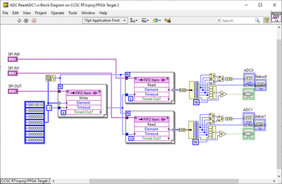

[LV2017] FPGA - compile error (formal cin has no actual or default value - NiFpgaArrayToCluster.vhd)
 I had to move on new PC with Windows 10, after installing LabView 2017 cannot build a project which was successfully building on old PC with Windows 10 and LabView 2016.
Xilinx generate an error for following vi:
Error:
ERROR: [Synth 8-2029] formal cin has no actual or default value [C:/NIFPGA/jobs/fcu90p5_aI2e7fi/ADC_ReadADC1_vi_colon_Clone13.vhd:259]
INFO: [Synth 8-994] cin is declared here [C:/NIFPGA/jobs/fcu90p5_aI2e7fi/NiFpgaArrayToCluster.vhd:45]
ERROR: [Synth 8-2029] formal cin has no actual or default value [C:/NIFPGA/jobs/fcu90p5_aI2e7fi/ADC_ReadADC1_vi_colon_Clone13.vhd:667]
INFO: [Synth 8-2810] unit vhdl_labview ignored due to previous errors [C:/NIFPGA/jobs/fcu90p5_aI2e7fi/ADC_ReadADC1_vi_colon_Clone13.vhd:53]
Any ideas, what can be wrong after migration from LabView 2016 to 2017 (and corresponding Vivado tools)?

if it has successfully compiled on an old installation, try repairing all the FPGA related packages from NI package manager.
(1,172 Views)
 It seems the new LV version cannot evaluate constant array size, so then I replaced net from array size vi to constant - it started to work.
