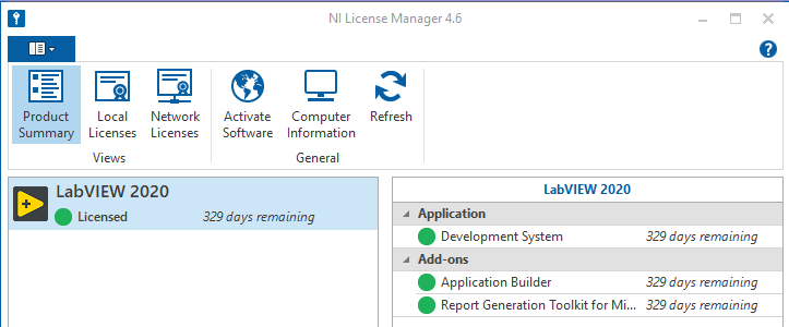

Unfortunately, I downloaded and installed Community Edition when it was first released (3 weeks ago?), and while I remember that the Activation Procedure was "weird" (and, as I recall, didn't seem to work the first time), it did eventually activate.
A successful Activation looks like a year-long Evaluation, as the Community Edition needs to be reactivated annually.  For example:

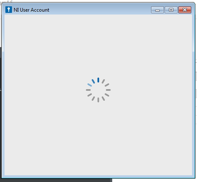

Activation stops at the NI User Account screen. Just does nothing.
Same thing happens if I try to activate through NI website.
