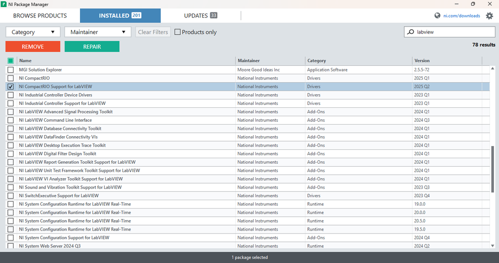

Hi Bob, thanks for responding. sorry but I am not getting your point, in my labview tools menu there is no option to click on or select the "Choose Environment".  😞
I may not have been clear enough with my previous comments. "Labview installation environtment" This error appears in labview after to install CRIO support drivers for labview. The only way that I know to fix this error is uninstalling or removing the driver "NI Compact Rio support for labview" but this is not possible if someone intends to work with CRIOs. For that reason I think this driver is the root cause of the error.
if you want to reproduce this error CRIO hardware is not needed. installing the CRIO driver in labview and calling Merge tool externally from windows console its enough to reproduce it.
Please let me know if there is quick way to enabling/disabling this driver or other solution to fix it. Thank you in advance.
