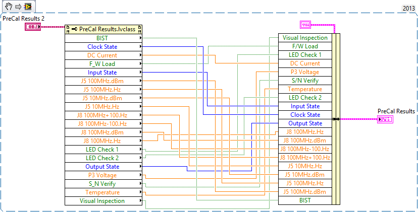

Why are the accessor elements in alphabet order and the bundle in cluster order? Yes I know I can clean it up. I was hoping there was an easier way.
It appears you copied out the class definition to create the type you are using for the Bundle by Name.
Quick tip that may be helpful
Drop a "Bundle" (not a bundle by name) and just wire from the accessors to the bundle and let the bundle adapt.
Right-click the top middle of the Bundle and do a "Create constant". THe new constant will get it definition from what you had wired.
Make the contant a type def ( you know how to do that)
Replace the instance on the diagram with the type def version.
Right-click the "Bundle and select "Replace" then navigate the "Bundle By Name".
